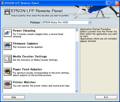

About EPSON LFP Remote Panel
EPSON LFP Remote Panel gives the user a broad range of control over the printer, to obtain better print quality in printing on various media.
Note:
In this User's Guide, screens of dialog boxes are intended for EPSON Stylus Pro 4400 and 4800.
The original printer driver and EPSON Status Monitor 3 must be installed to use this software. For more details, see System Requirements.
Select the printer from the Printer list, and you can access the following functions by clicking the icon in the EPSON LFP Remote Panel main dialog box:
Power Cleaning:
Use this function if nozzles remain clogged after a normal head cleaning. See Power Cleaning.
Firmware Updater:
Use this function to update the firmware installed in your printer. See Firmware Updater.
Media Counter Settings:
Use this function to count the quantity of media remaining so that an alert can be made. See Media Counter Settings.
Printer Watcher:
Use this function to monitor the printer status. See Printer Watcher.
